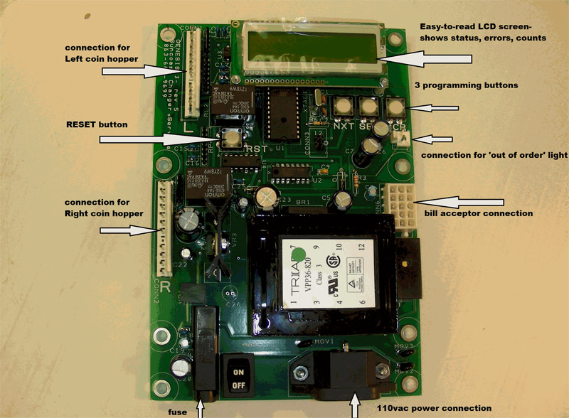

American Changer universal boards can do it, and this replacement board for American Changers can do it. They call it a stringing deterrent, but it can be used to prevent people from wiping out your coins also.

Pretty sure my bill breaker / coin combo can give less than the amount inserted. It's a standard change makers BCX1020RL. It also has the option that Keno mentioned to go out of order for whatever you program it to do after so many of the same bill, which helps a little bit, but they will still take what they can get, you also get reports that tell you when the bills were inserted so you can figure out who they are on your cameras.
