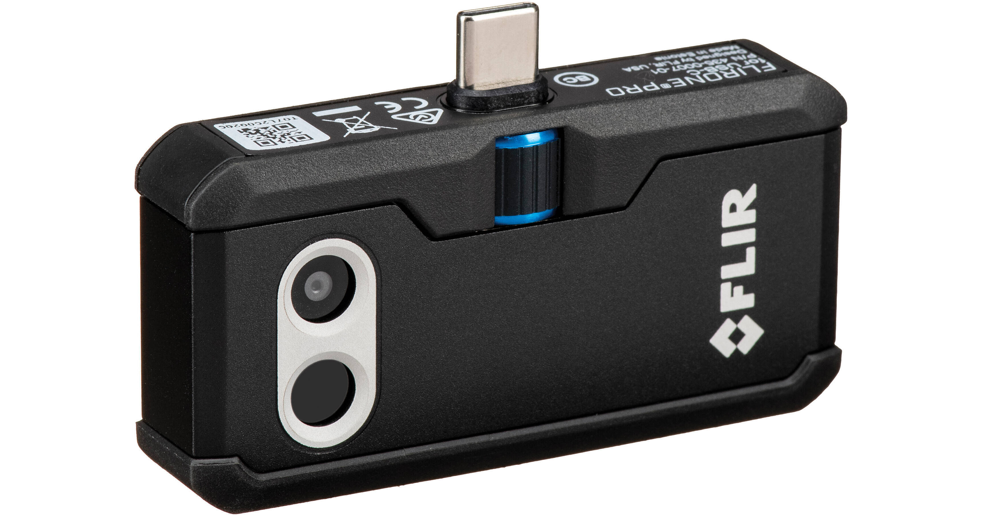

I just bought a FLIR infrared adapter for my iphone. Can't tell you how valuable this thing is on in floor heat. If you can get system to hold glycol, even for a short time it may find the leak for you. It's kinda like reading Xrays, you will feel like you can't see anything for an hour or two then it will start to make sense. I think you would see where it is pooling if it leaks that bad. I also have redone an old bay with 1980's version 1" black poly pipe. Changed it to insulated slab and 3/4 pex and it is about 12 degrees air temp warmer than previous system with same return water temp and closed doors. 5 bays to go to get them all if my back will stand it.

Cost is about $200 for the FLIR ONE available on Amazon. I have used it for a few weeks to locate floor heat and slab heat pipes to avert drilling through them. I have concrete 5" to 8" thick with heat tubes near bottom of pour and it "sees" them fine. Fancier units are available, but this seems fine to me. I was familiar with FLIR from past experiences and they are top notch in the infrared field

Seeing the difference in specs on the Flir One ... the following might be worth the extra money:
