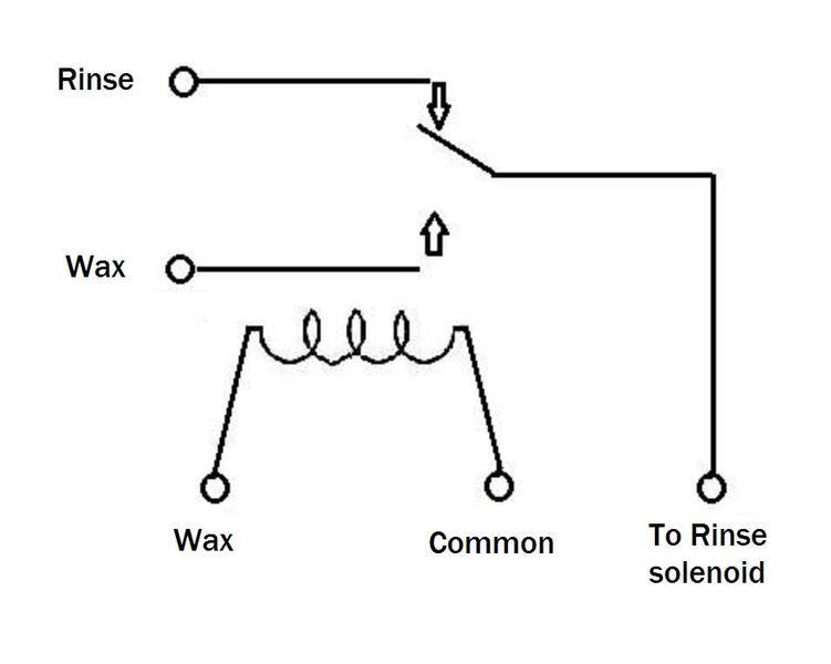

Same as above only worded differently, I had copied this from another post on the forum a while back:
Use a SPDT relay. You'll input the voltage for rinse to the NC on the relay, the wax function to the coil and looped to the NO contact. Then the output of the relay goes to your cold water solenoid. Whenever either function is selected the solenoid will get power with no cross-current between them.
Yeah, I failed a bit on my labeling, but I was tired so I just grabbed a SPDT relay diagram and labeled it. The ones labeled "RINSE" and "WAX" are the signals coming from the rotary switch.
NP....I understood your diagram, but wouldn't have before buying a CW! :-) So I figured others might have the same problem. Hopefully now both diagrams make sense to those who don't know how to wire one. I just looked at my drawing again...I could have done better!
