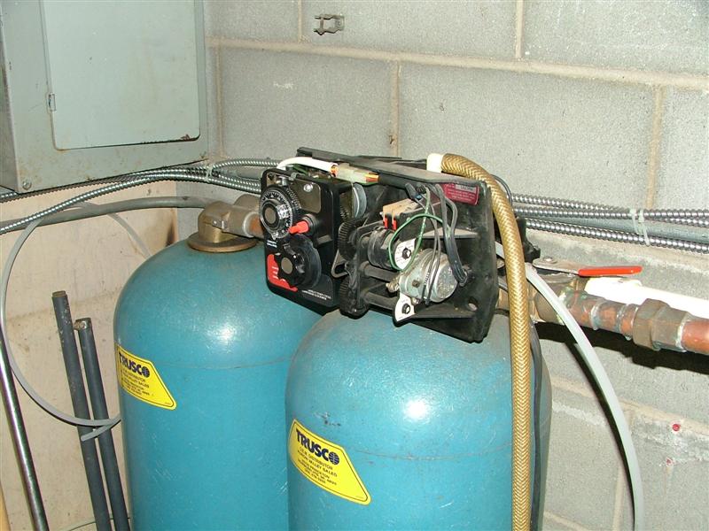

I have a Fleck 9000 Softener and (2) 12 x 48 or 64,000 grain tanks. I haven't done much studying on the softener until now...I checked the output water and I'm at less than 1 grain hardness so the system is working properly...

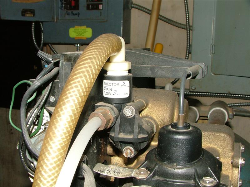

Look at the injector on the back - it has a black or red sticker on it which tells the fill flow (IIRC, black is .5 GPM, red is 1 GPM). Then open the timer door (Unplug the meter cable from the meter first) and look at the pins. The first row of pins determines the backflush time, then a long gap for the brine rinse time, then the second row of pins for the settle rinse time. The number of pins missing after that sets the brine refill time. Example: 1 GPM on the brine valve, 1 min. per pin, 2 cu. ft. resin, 3 lbs. salt per gallon = four pin gap for brine refill.

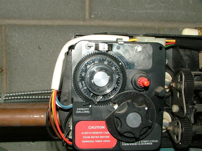

The manual is confusing when setting the gallons before regin. Is it as simple as pulling the dial out and rotating it till the gallons lines up with the white dot....
The manual says this, assuming you need to set the dial at 950 gallons:
NOW set Meter wheel at approximately 950 gallons. Lift the inner dial of the meter program wheel so that you can
rotate it freely. Position the white dot opposite the 950 gallon setting.
This is the part that doesn't make sense. It says "Position the white dot OPPOSITE the gallon setting"....

OK Looks like I have a bastard alligator! I DO have the 1" Extended Range Meter Cover, but I have the Standard Meter Dial with a range of 350-5270 galllons. I should have a dial with a range of 1,550-26,350 gallons...So trying to set this thing is useless without the right parts. At least the dial will be the cheapest thing I need to replace. Here are some closeups...The Injector is labeled #2 indicating a blue Injector (.25gpm)and the sticker also says 3 gallons per minute. I'm confused what the 3 gallons per minute represents?

The drain 3 GPM just tells the maximum it will flow during the backwash and settle rinse. It's irrelevant to setting the brine usage.
It should read "next to." In your last image, it's set to 3,000 gallons.
