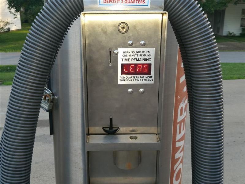

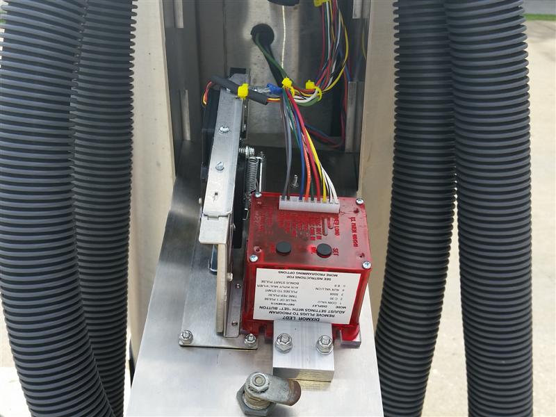

That almost sounds like something your going to have to have custom made. 2Biz installed LED-7 timers in his small vac coins not long ago, I think he used a shoe horn to get them installed, but he did it.

Etowah valley made custom face plates for me, very reasonable price.
Do you remember the price of the custom faceplates? I ordered 4 new plates from Doyle so I could have time to get the machining done and install all at once. I think they were $45 each.

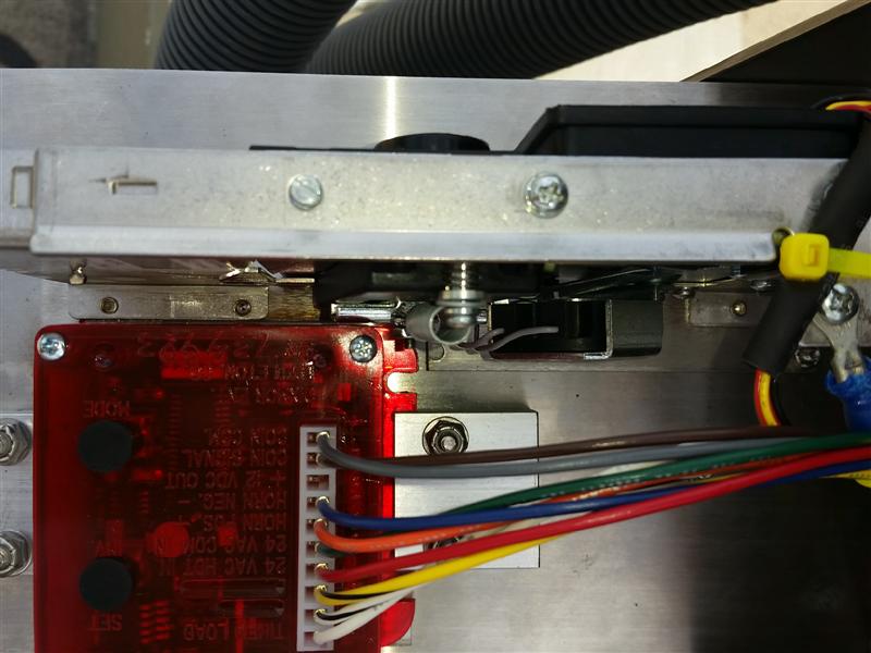

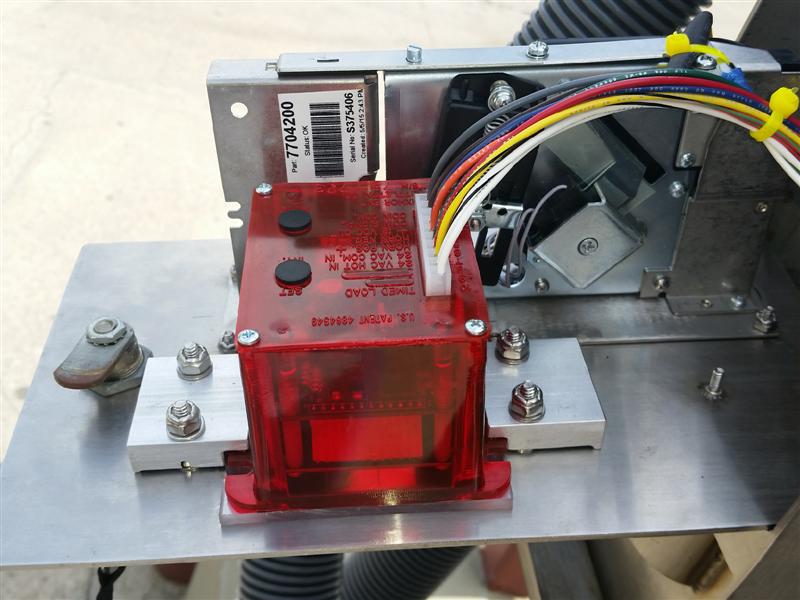

I did something similar to what 2Biz did - the plate may be wider since I didn't have to hang the timer over the edge of the acceptor.

Wow, that is tight! A MicroCoin is a little bulkier than that Sensortron. I doubt that you could squeeze the LED-7 in there. Possibly, if a new door was made, maybe the coin mech could be moved over to the left a little? The coin drop hole would probably need to be enlarged if you went that route.

Yea, It took a bit of measurin' and calculatin', but I must have been up for the challenge!
That Microcoin fits in the same size frame and doesn't look any thicker than the Sensortron...I bet it will fit!

2biz: thanks for the photos and the description. I'm going to do it as you show and describe. There isn't much room in there that's for sure.
2biz: You say you put the transformer up under the dome? You ran the wires into the main body of the vac and then up through the top?
