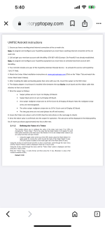

Here you go
Thanks! We connected the other red/green wire and had to have Cryptopay configure the Tap Plus with the Wash Select II on their end. Now to solve our Cash App acceptance on the Tap Plus issue. For some reason the Tap Plus accepts Cash App...charges the customer, but does not start SS bays. CryptoPay says they accept Cash App, but Cash App needs to be funded and not pull from their bank account. Had a customer show me his Cash App had plenty of money on it, but still did not make a transaction. Anyways...guess that is another thread. Thanks again for the help.
