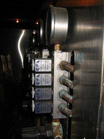

I am just wondering if anyone is having trouble with the 24 volt coils from KR that are for GC manifold blocks. It seems that I am having to replace them way to often and was wondering if I have a bad batch or if I need to change out to a different brand of manifold and coils . I have checked to make sure they are getting proper voltage several times and have no issues there .

There is 56 of these coils on this stand and about half of them have been replaced. It appears that CFA has changed their manufacturing process. I can look at the older coils vs the newer ones and see a difference in the form they are molded with, it's only the newer ones that seem to not last long. I am just wondering if they have changed to a lower grade of copper inside them or some part of their manufacturing process is just not what it use to be .
It might be a good idea to check the voltage. If you have 208V going to 240V transformers, the voltage to the coils will only be ~21V and they'll get hot and fail prematurely.
