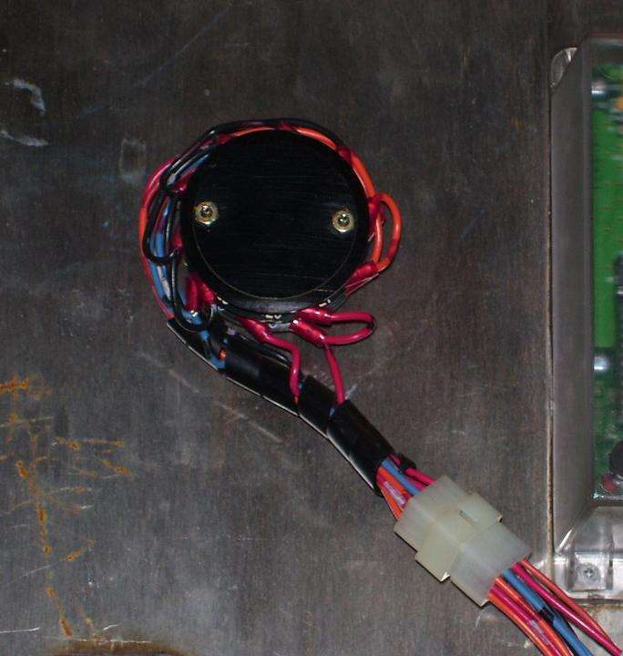

Are you using a rotary switch? If so, I would check the connection of the timed load from the timer to the rotary switch. I would also check to make sure you have voltage across the "stacks" on high pressure rinse.

If the key switch bypasses the rotary switch and powers the motor contactor directly, and only the high-pressure is affected but not the low-pressure, it must either be a loose wiring connection near to the rotary switch or the switch itself is failing.

Water supply is there when he uses his key to turn the bay on so my thought would be electrical. Look for loose screws on the rotary switch; check the wires in the bundle to the rotary switch. If they go to a terminal board in the coin box then check that also. Look closely if there any of these wires that look "flat" like they've been caught in the faceplate door when you close it. That can cause a break in the wire without cutting the cover:confused:

one of the possibilities i can see now after reading through is a bad rotary switch since i eliminated the timer already and i see that the power is not coming to the control box from the bay and , it seems like loose connection and that is why it intermittently works..yeah it is still only with the high pressure though. i checked for loose connections or trapped wires or cuts nothing obvious.

Check for power coming out of the rotary switch for the motor outputs. You'll see at least three of the outputs jumpered together, usually with loops of wire crimped into the spade terminals on the switch. If "STOP" is at the top on your selector from outside, 11 & 21 will be at the bottom on the back. Make sure BOTH these are connected together securely. That jumper being loose or having a bad crimp that has corroded will cause your problem. Then check for power coming from the jumpered outputs from the switch. If you're getting power at the switch, follow and test the wire all the wy back until you find your problem. If you're getting no power out and you're getting power in, the switch is bad.
