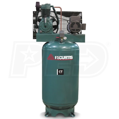

I bought this for my detail shop. It's been really great.
I tried to economize on a couple of air compressors before this and regretted it both times. The first time I had a very loud unreliable temperamental Ingersoll rand that I burned up in less than a year. Then I spent about $1000 on a husky compressor from Lowe's. What a mistake that was. I was constantly replacing the reed valves over and over because it was not meant to run continuously sometimes like it needs to in the detail shop. This compressor might seem expensive but it's well worth it when you consider how Maintenance free it is.
