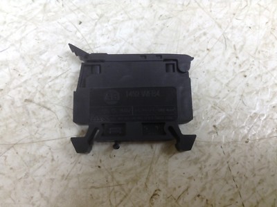

FWIW ... I wonder how many of us car wash operators use din rails??? With our dog wash redo we are now using some nifty din rail Allen Bradley lever style 5x20mm fuse holders. Time will tell ... on what the specific advantages that approach turns out to be overall though. It does combine a quicker ability to shut off specific power area ... similar to Dan's 4amp breaker approach. I suppose some affordable breakers might allow for a change in the specific amperage protection ... not sure.

Here is another similar lever disconnecting fuse holding device from Omega: https://www.omega.com/en-us/tempera...MI2oqp-8Hn-gIVrCStBh2AaQtNEAkYBCABEgISdPD_BwE
Since the fuses can be bought from Digi-Key for less than a dollar each ... I see an advantage over a breaker in that the more precise amperage protection can be tweaked a bit easier & more affordably!

Just like Mouser says a simple reset button for whatever is included in its circuit ... it does not look like it can lever disconnect its included circuit like the "lever style" ones that I linked to. Is that the exact specific style of breaker that Dan K was referring to?
Back in the day on our older washing machines we used to call your linked Mouser reset breaker "the overload button".
Funny I was visualizing Dan K's GinSan pump stand circuit breaker similar to this one:
https://www.automationdirect.com/ad.../miniature_supplementary_protectors/gmcb-1c-4
Then again ... the specifi pump stand ... which I am not familiar with ... would need to have a din rail or modified to include a 35mm din rail.
