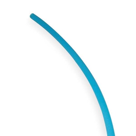

I may have just found a better replacement poly-tube on Zoro.com with the same specs and better rating then I'm using now I'll keep you informed once it comes in.
N11 tubing is rated almost twice that pressure and is actually cheaper on this site:
I stay away from any colors, especially red, and also clear. Even indirect sunlight breaks it down quickly and it gets brittle. Black N11 won't degrade from sunlight at all. A sacrificial piece of the lower burst rated tubing is a good idea.
DiamondWash
2,353
448
Des Moines, Iowa
*Update* the poly-tubing I ordered I thought was from a different company then what was on the Razor originally was, in fact, the same company, same hose, and specs BUT the total price was unbelievable from Zoro.com cost me around $65 for what other companies even the manufacture wanted almost $150 for the same thing! Zoro for the win AGAIN
