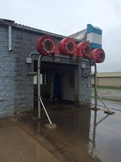

Here's a picture of the dryer outside after 10 years.

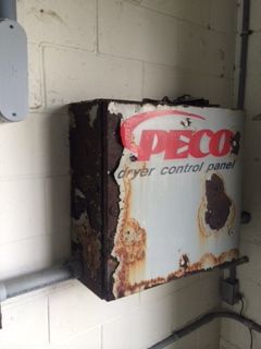

Here's a picture of the control panel after being in the bay for 10 years. You tell me the best location. Keep in mind that this bay houses a friction wash, not a touchless with harsher chemicals. I can't believe a company like Peco would put out a steel enclosure, knowing that it would be in a car wash. What a piece of garbage.

I.B.W., it seems counter intelligent, but....looks obvious to me, that youd want your dryers outside the bay (& your control panel to be plastic or S.S.)! IF you think about it for s lil bit, the rain isn't harsh at all vs. IBA chems!
3,264
774
Also, how many feet outside your bay, are those dryers located? Mine are free standing dryers, just inside the bay yet about 2 feet past the IBA (when docked) & I constantly have to tell folks to pull forward for the dryers...
