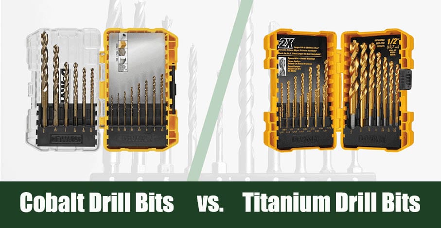

You can't sharpen pilot point bits, and once you do the titanium coating is gone. Might as well use regular HSS bits.
Thanks MEP001,
This even confirms what you say but is a bit more thorough in a worthwhile way! Dewalt has a pretty good reputation & they sell both:

I have set of Dewalt drill bits and they didn't last very long. You get what you pay for. It they are not made in USA or Germany they probably are not very good.
I bought a set of Dewalt bits, mostly for the case. They were okay, the pilot point was handy and in thin material they saved time over drilling a pilot hole, but I wouldn't buy them again. I will be buying more Milwaukee cobalt despite them costing twice as much as the pro grade.
