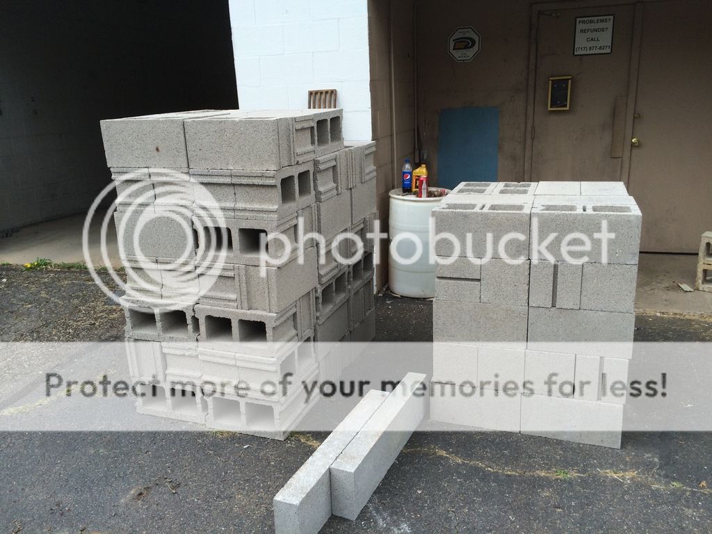

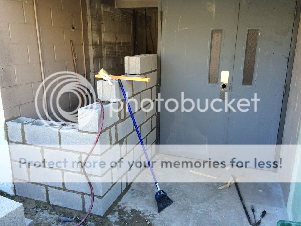

Going to install a bill changer in a wash we got last year. Have to build a new wall.and put in double set of Steel doors, there wood now and a 3 year old could kick them in. Anyone know the correct height to put it in at.
Never did block work so it will be a cluster **** or a total waist of time or it may work. Thanks
