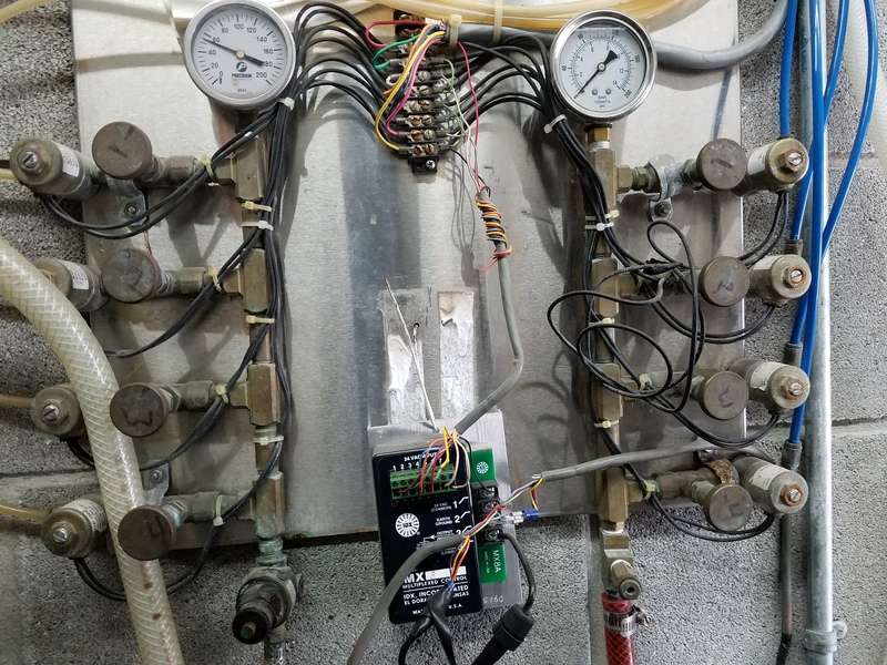

Presoak snot (Kleen-Rite's Purple Passion):
Not done by an electrician (The bare spade with the blue crimp is live 120v, and that's 22ga. wire tripled up to go to a 1/3 HP Procon motor):

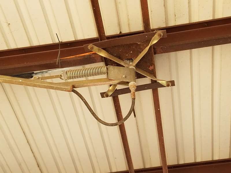

Boom swivel (Or is it?):

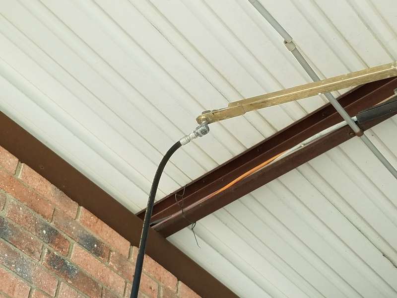

Same boom:

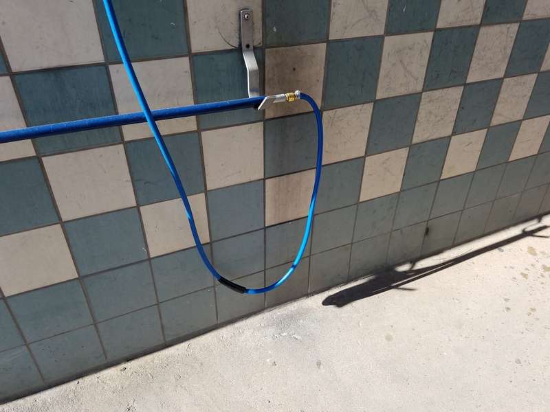

Bay still in service, been like this for years, owner doesn't understand why the wand is always getting broken:
