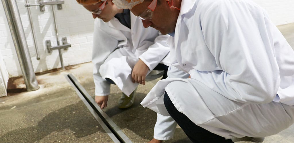

Got a look in the equipment room last week and found out that there's space on the pump rack for another two pumps. So thinking that would make it a little better to add a bay to the outside for larger vehicles.
Found the slot drain system while tinkering around and looking to get pros and cons. I think that I'd be able to do a longer run of drain to cover longer vehicles without the whole covered pit concept. Mount a meter system to the outside wall and be able to secure the larger fleet market from the local businesses, and maybe open to expanding to an attendant model with trailer washout. But I digress...
So, slot drain experiences for a selfserve open bay?
I've seen a lot of older washes that have a trench all the way through with a grate over it. It's wide enough for a shovel - the downside is you'd have to pick up all the mud by hand, maybe once a week or more, but no pumping pits.

I haven't dealt with the trench-type thing in a car wash, but I've watched owners do it. The floor is still sloped so you can wash mud and dirt into the trench, then you remove the grates periodically and shovel the mud out. I would be concerned with a narrow slot because not only will it be difficult to rinse dirt into it, it might be prone to clogging.
The drains have optional flush valves that can be connected to a sump and set on a timer to automatically flush at intervals. They also have what's looks like a scraper type tool that mates with the drain to clean stuck debris.
I know part of the concern with an open bay is rainwater flowing to the sanitary sewer and I think that this set up would help to reduce that while also allowing a longer drain area for bigger vehicles.
They're also designed to be driven over.
